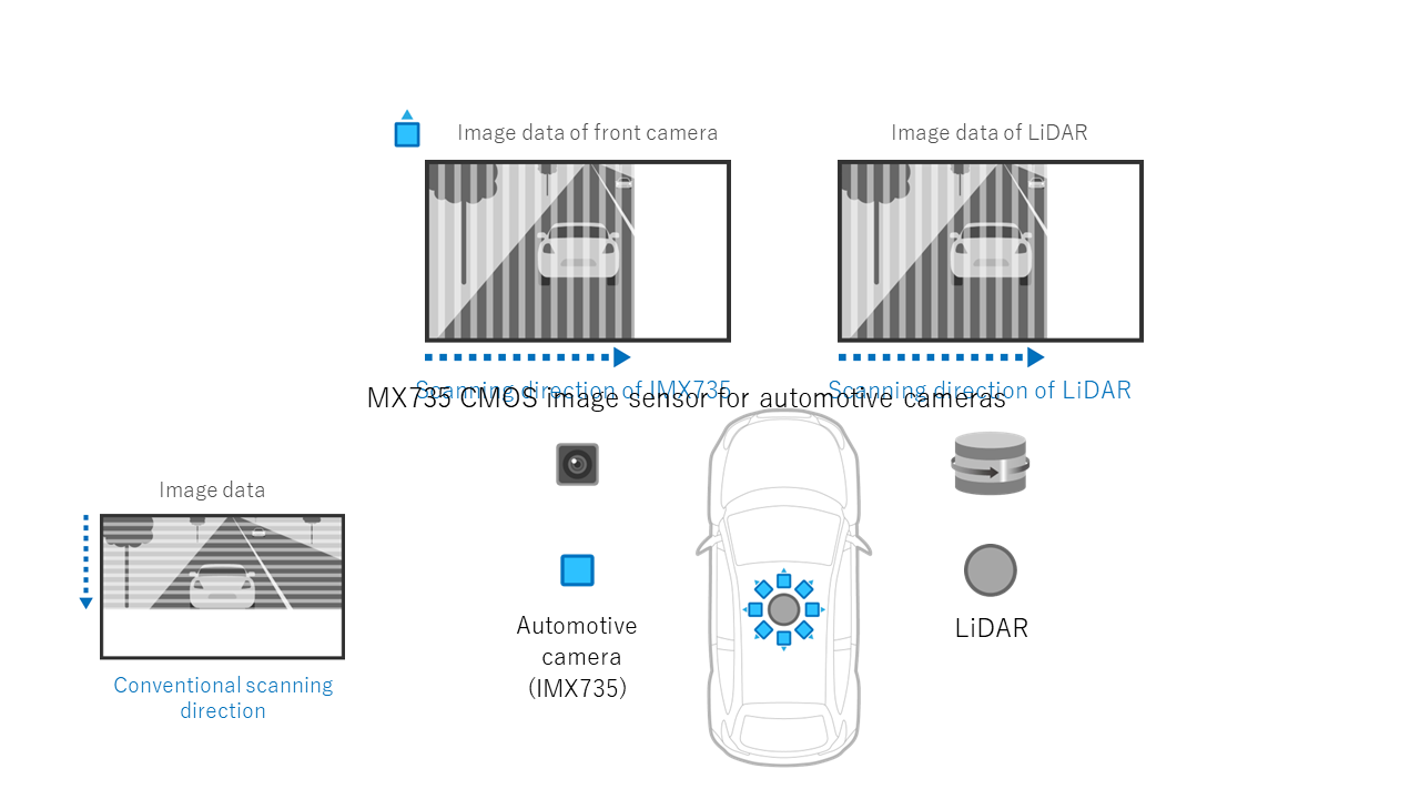

The new sensor product achieves the industry’s highest*1 pixel count of 17.42 effective megapixels,*2 enabling high definition capture of far-off objects. Moreover, automated driving systems often use automotive cameras in combination with LiDAR and other sensing systems. While typical CMOS image sensors readout signals output from pixels one vertical line at a time, this product outputs signals horizontally, one row at a time. This means that automotive cameras employing this sensor can more easily synchronize with mechanical scanning LiDAR*4, since their laser beams also scan horizontally. This better synchronization will improve the sensing and recognition capabilities of the automated driving system as a whole.

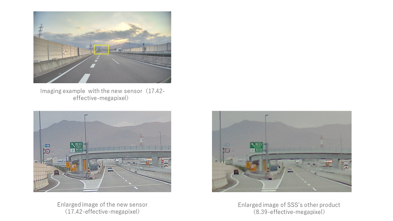

Long-distance recognition delivered by industry-leading 17.42 megapixels
Thanks to the industry’s highest*1 pixel count of 17.42 effective megapixels,*2 the new sensor is capable of high definition capture, extending the object recognition range to greater distances and thereby allowing better detection of road conditions, vehicles, pedestrians and other objects. Early detection of far-away objects while driving helps make automated driving systems safer.
■ Horizontal pixel signal output for easier synchronization with mechanical-scanning LiDAR
When reading signals from pixels, CMOS image sensors generally do so in a vertical direction one line at a time. This product, on the other hand, employs a readout method that outputs signals horizontally one row at a time, making it easier to synchronize with mechanical-scanning LiDAR, which also uses a horizontal scanning method. This means that the information output from automotive cameras equipped with this product can be integrated with LiDAR information downstream on the system. This will improve the sensing and recognition capabilities of the automated driving system as a whole.
